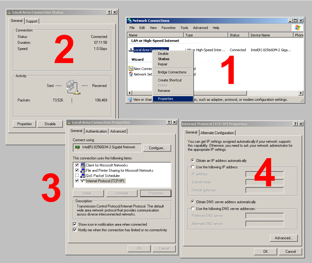

Well, you need to make sure you're matching your home subnet not just using 192.168.1.2 when you're running 192.168.12.1. Go to a PC on the network and verify the IP information before following the tutorial. Now, if you do indeed want WIFI in the outbuilding turn it on otherwise you'll need to cable up to the OWRT device. Now for the reuse of the ISP HH there might be an issue if you haven't default it using the paperclip to clear the config prior to trying to setup OWRT. Reflash OWRT to it and try again. It's also possible your IP scheme is already using 1.2 for an IP on something depending on how you have your IP range setup. If you do an arp on the PC while checking the IP info you can see the IP's in use.
C:\Windows\system32>arp -a
Interface: 192.168.0.170 --- 0x12
  Internet Address      Physical Address      Type
  192.168.0.1           5a-ea-69-a9-d9-fb     dynamic
  192.168.0.2           5a-ea-69-a9-d9-fb     dynamic
  192.168.0.50          5a-ea-69-a9-d9-fb     dynamic
  192.168.0.65          bc-cf-4f-d7-5f-20     dynamic
  192.168.0.102         00-18-dd-0a-24-7a     dynamic
  192.168.0.104         00-22-6c-04-11-61     dynamic
  192.168.0.105         00-bb-c1-9a-fe-2c     dynamic
  192.168.0.110         10-2c-6b-7d-11-50     dynamic
