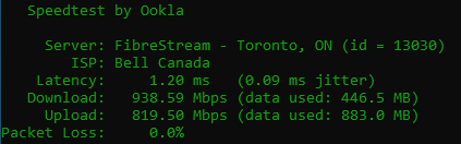

I'll add to this in that even with the same server I get wildly different results. Computer is plenty capable i5-9600K with SSD running Windows 10.
Here is the result from their website test
And the exact same server using the CLI in Windows command promt.
