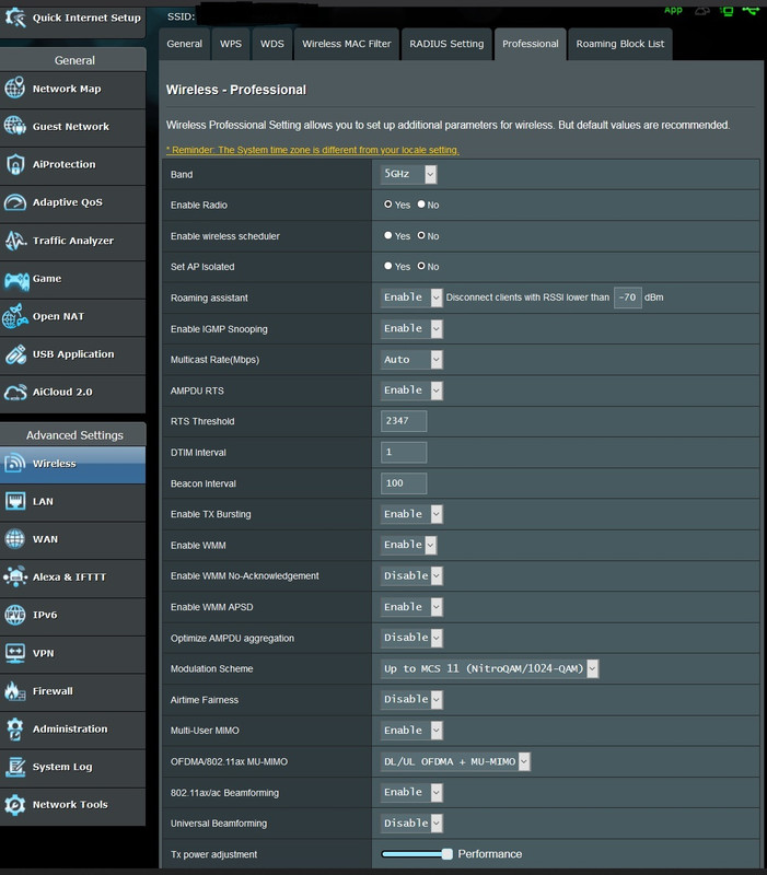

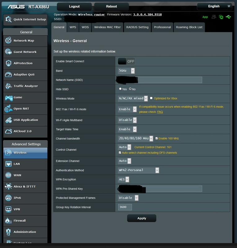

Hey guys not too long ago I purchased the AX88u and it was even worse then AX86u right now. I have the Verizon Fios plan 200/200 which is actually 300/300. This router has very poor wifi speeds with AX/AC modes I tested both. I tried newest firmware from ASUS, also a beta firmware and right now i have merlin alpha 4 which seems to be slightly better.
The router usually does around 200 to 250 on both down and up (average). I tested my friends nest-wifi AC2200 I think - and it was giving me full speeds on all my devices on Wi-Fi.
I will attach my settings here so maybe someone can help me out. PS - I did test manual channels/auto literally bunch of configurations. At the end it doesn't make any difference.
I can't return the device anymore as I bought it about 2 months ago now.
Does switching to 80MHz channel make any difference? Also try setting "Protected Management Frames" to "Disabled" or at least "Capable".
Thanks for your reply. For some reason even in AX mode my devices won't connect to 160mhz anyways. Just changed to 80mhz and this is the result - usually it's around 200-250 mbps.

What speeds does your router report for the client that you use for Internet speed test? And did you try with all TrendMicro things turned off?
Maybe you can try turn off gaming boost or any QOS setting
And for utilizing 160MHz, you need to use specific DFS channel 52-64 or 100-140.
