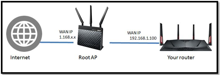

I have an AC5300 - I can connect to instant guars locally but not from externally...
I followed the guide here:
After setting up fort forwarding UDP 500,4500 to my local router IP 192.179.2.1 and try to connect via the App it says:
Termporarily unable to activate instant guard. it conflicts with port forwarding rule using UDP 500 and 4500 port. Please disable port forwarding rule in order to use IG.
So why in the article is it asking me to set port forward?
How to fix that?

The guide says:
«Your router connects to Internet through another router (here we called "the Root AP"). The Root AP assigned IP address to your router. In such case, you have to set up Port Forwarding, NAT Server, or Virtual Server on the Root AP to make Instant Guard VPN available for private IP address.".
The Root AP - is your provider's router. Make an agreement with your provider, if it works out... Or get a personal public ip address from your provider.

Here is my Setup,
I have a modem thats connected to the AC5300 WAN interface...
I have a fixed IP set on the router 196.219.98.x
My router IP is 192.168.2.1 and has an external WAN IP of 196.219.98.x
My modem IP is 192.168.1.1
I can access both from my browser...
Where shall I set the port forwarding? if I set it on the router, i get that error message...
So why then it wont connect externally? it will only connect if im using Wifi of the router...
I'm going crazy!
I think I can explain some of it.
In the picture from ASUS, note that the WAN ip is actually a local ip (from the root AP). That means it's using two routers, both having local ip addresses.
In your case you are actually using a proper WAN ip, going to your router with a lan ip:
That means you only have 1 local ip address, and one WAN ip address. There is therefore no need for port forwarding.
So it would be like in the Asus demo:
Internet- Wan IP -Device A - Wan IP (which is actually a Local IP, the one from the device A) 192.168.1.100 - Device B
In your case:
Internet- Wan IP -Device A - Wan IP (which is actually a proper WAN IP) - Device B
Basically your 192.168.1.1 is irrelevant, it's the only way to connect to your device A, but it's not taken into calculation by your local network. You properly have a subnet directly connected to the internet.
That's why you do not need any port forwarding from device A to device B.
