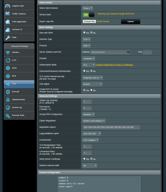

Just wanted to follow up with what I think is a working solution.
Just to recap: I used the Road warrior OpenVPN install on two separate VPS's. Server 1 is being used as a persistent VPN tunnel to secure all traffic from router. Server 2 has a number of web based resources running on which are bound to various port numbers. I did not want to open those ports to the internet and instead wanted a second persistent OpenVPN connection to that server so I could securely access the resources when on my home network.
Since I control both servers I left Server 1 with the default OpenVPN subnet of 10.8.0.0/24 and updated Server 2 to use 10.8.1.0/24 to avoid subnet conflicts. I then set up OpenVPN Client 1 and Client 2 in Merlin to point to the respective servers.
Client 1 (Tunnel all traffic through VPN)
Client 2 (Access local resources on Server 2)
Two additional things I had to adjust in order to get everything working. I added route-nopull to the Custom Configuration of Client 2 to override the redirect-gateway and dhcp-option set by the Road warrior setup (I could probably just remove those from the server.conf as well). I also had to add a policy rule on Client 1 for accessing Sever 2's subnet of 10.8.1.0/24. I found that without this I could not access and of Server 2's resources from any device connected through the VPN on Client 1.
I just wanted to get a sanity check that this sounds somewhat correct and I haven't opened myself to any potential security risks. Also curious if there is a better way to tackle this?
