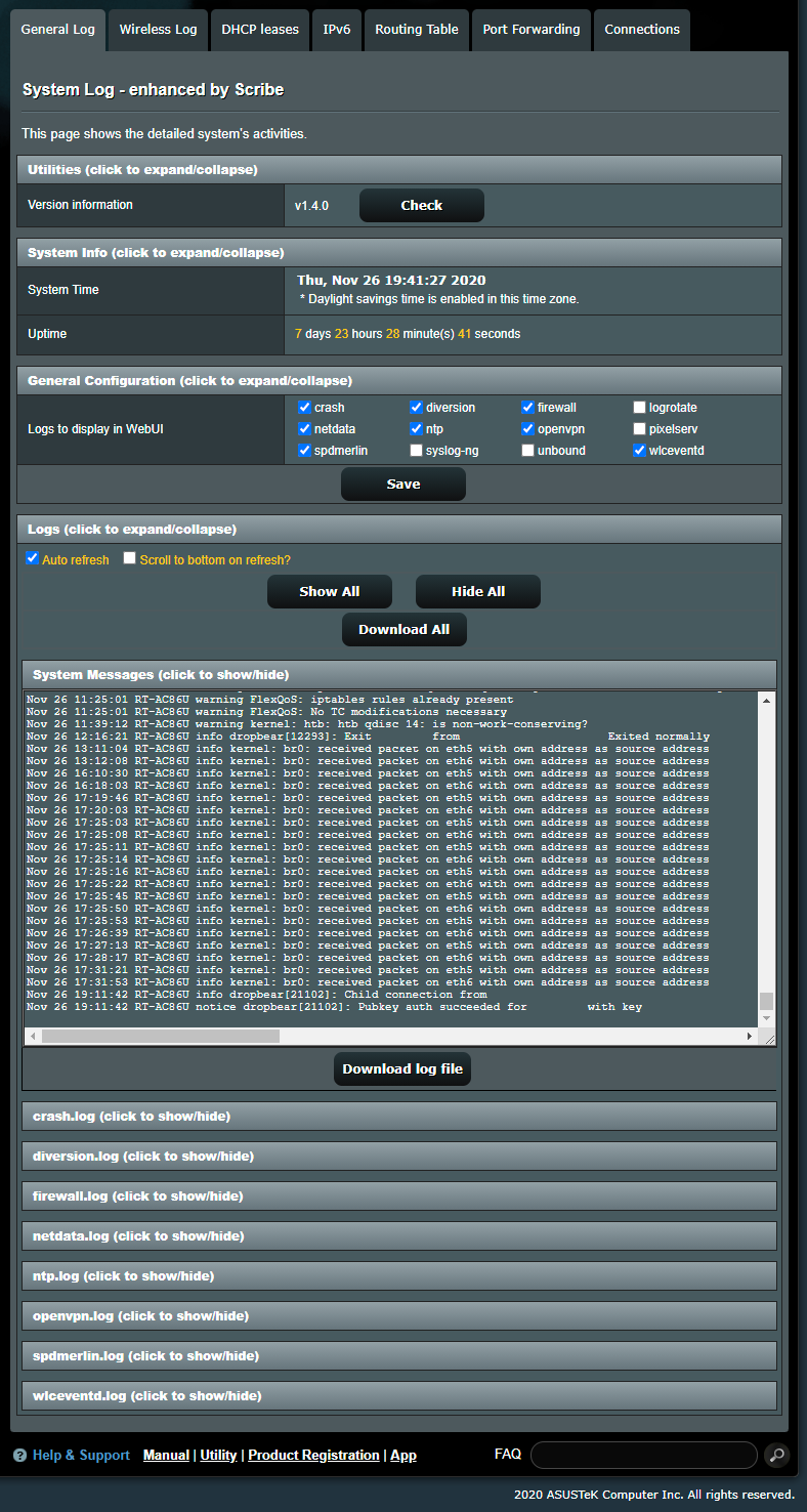

uiScribe can be configured via the WebUI, on the System Log page.

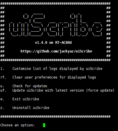

To launch the uiScribe menu after installation, use:
uiScribe
If this does not work, you will need to use the full path:
/jffs/scripts/uiScribe

This installs, and messages shows OK. The other logs have headings like this:
Block source osquery(file("/var/log/osquery/osqueryd.results") prefix(".osquery.") ...) { Messages (click to show/hide)
and in the box show "Log goes here".
I don't have all the examples scribe might install, but I have pixelserv-tls (irregularly named, maintaining my respect for @kvic's work) and skynet-0 and openvpn. How do you choose what will be shown and what not?

I made an assumption that all logs would be pointed to /opt/var/log and end in .log
EDIT: isn't /var/log part of tmpfs rather than a persistent storage location?

1. I think it is a safe assumption that all logs would be pointed to /opt/var/log. I don't know why some of these blocks are referring to /var/log.
2. It is not a safe assumption that all logs end in .log, but I think it is a good practice to enforce. Messages, for example, doesn't end in .log, and there is nothing that guides someone to define a destination file as including it (I have a file called startupmessages, for example, which is the syslog.log file up to killing syslogd and starting syslog-ng). I'm assuming this way you can ignore the rotated logs, compressed or not. We also have the dnsmasq.log created by diversion; I have a collectd.log file.
3. I do not have a number of other logs that are not relevant to me: the wlcevent log, the crash log or netdata logs.

I can improve how I parse for logs - the assumption was deemed to fit 90% of the intended user base, so I could get a PoC out there to see if anyone would be interested :)
The list of logs is pulled from syslog-ng itself, and whichever filters you have in place
dnsmasq.log simply grows too large to render well
