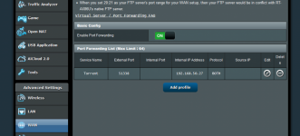

I am on the RT-AX86U with latest firmware and have the same problem.
Tried to forward my port for qbittorrent but online port checkers always tell me that my ports are closed.
Attached are screenshots from the configuration of the router.
Qbittorrent ist set to listen to "51338" and also us "UPNP".
UPNP and Secure UPNP are both enabled in the router.
Any suggestions? Could it be an issue with the firewall of the router?

Qbittorrent is set to listen to "51338" and also us "UPNP".
Manually forwarding ports as well as enabling UPnP will create a conflict causing UPnP to use pseudo-random external ports (see image below). Use one method or the other but not both.
That said, in your screenshot I'm not seeing any ports shown under UPnP which suggests that qBittorrent is either not running or not using UPnP.

Leave UPnP enabled on the router.
Set the port you want in qBittorrent. Then either, 1) check the UPnP box in qBittorrent , or 2) manually forward those ports on the router.
Obviously UPnP won't work properly if you're routing the client PC over a VPN connection. That said, I've found that it makes little difference what port you set for qBittorrent because modern BitTorrent clients will negotiate dynamic ports anyway making that setting largely pointless.

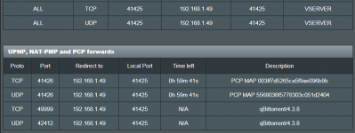

But this also means I cannot manually port forward any ports. E.g. for xbox or so?
Would it be better do disable UPNP on the router and go the hard manual port forwarding way?
Because I now have UPNP on the router enabled which, as it seems, conflicts with manual port forwarding.
On the other hand, maybe with UPNP any manual port forwardings will be obsolete anyway.
For games/consoles it's much better to let the game/console use UPnP rather than trying to use manual forwarding on the router. If you have something that can't use UPnP then you can use manual forwarding for that.
