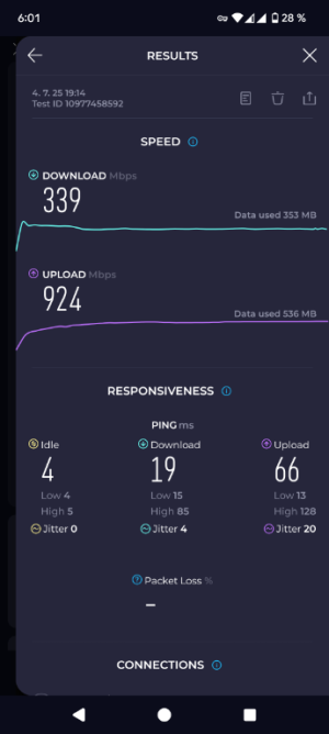

Does this count?

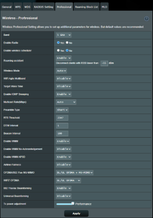

If all the same try disabling all this and test again.
And your routers must be really close to each other if Roaming Assistant at -55dBm is needed.

If that's true then how do you explain this:
With out more context, there isn't much to explain.
