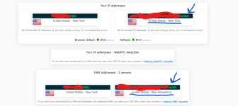

Hello, I was wondering what I had to to do get unbound to work with Ipv6, right now It seems like only Ipv4 is functioning correctly. I was looking in the advanced unbound config and tried to turn on integration IPV6: do-ip6: yes and reboot but it still seems like the v6 is not working correctly. I am verifying if unbound is working by checking https://ipleak.net/ my ipv4 and ipv4dns match but my ipv6 and ipv6 dns do not match.

Ok, and I assume the address i put into there is my LAN IPv6 Address correct? That is the equipment of putting in192.168.1.1 as my DNS but for v6. DNS filter was turned on but did not have a V6 address in. Ill check around for IPv6 DNS settings as well.
Something interesting I was just looking through my IPv6 settings and realized my WAN IPv6 Address matches my IPv6 DNS address on that test but does not match the IPv6 address of the test. Odd it says that address is in NH while I am in NY. Is there another way to test Unbound? Also in general cached DNS requests (once the data is cached) will be faster than any public DNS correct? That honestly is the main reason I am using unbound.

I just checked all of that and it all looks good I guess it all is working, after all, I just find it odd that this doesn't match up. I assumed it must have to be matching to be working, I am in NY maybe it's just getting the location wrong because I do see that second address as my WAN IPV6. If that is true should it be in NY. Are there multiple separate addresses in IPV6 unlike IPV4?
Maybee your ISP using some tunneling service or their exit point is somehow different between ipv4 and ipv6. I have no idea how these localization services work, guess the ISP is responsible to report where your IP belongs. but for DNS... who knows?? guess the localization may not be based on what the isp states but may be the point of origin where your ISP is connected to the main-line...
One difference could be that your only have a single ipv4 but a whole bunch of ipv6. Naturally the client data will have the clients ipv6 address but for dns it will be router ipv6 so slight change on device suffix but as long as its your prefix: its cooming from your network.
but the important thing is that this is not your problem... some internet service gets location wrong, its their problem... Enjoy Unbound!
