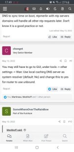

Is there a way to see that unbound does realy work?
And is this sentences still right, because on the pre recommended settings it says something different.
Also on the website https://www.dnsleaktest.com/
should it show the router ip as my dns?

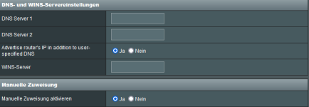

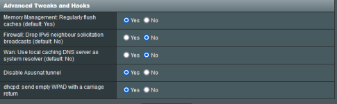

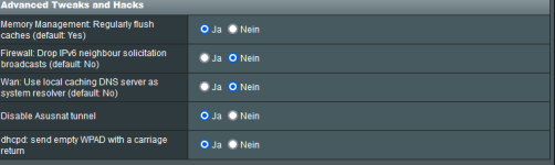

Are my Unboud Settings Correct i post some screenshots
Unbound Settings

On the DNS Leak test it shows my WAN IP and not my Router IP it this corrcet?

As @dave14305 has pointed out, you should see your wan IP address as your IP for dnsleaktest.com (possibly even your ISP hostname attached a long with it.). Another method is to look at your unbound statistics to see if your cache is growing in usage. Another option is to type pidof unbound into your router SSH terminal command line. You should see it return a number if unbound is running; however, this does not provide any indication of what clients are actually using ito_O.
