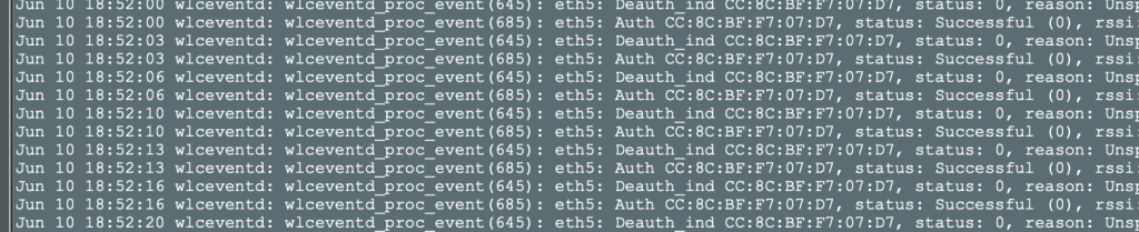

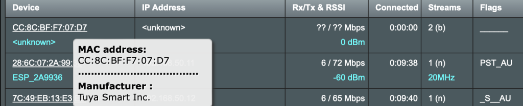

Hi, I have the same issue happening after an update to the 388.7 version. I have the RT-AX56U and I understand it is EOL however this issue is very similar to yours if not the same: a random device with MAC address starting with CC:8C:BF (Tuya Smart in wireless stats) keeps trying to authenticate. Not sure if it is an actual device or a bug. Currently trying to block it and test again.
Are you using any Tuya Smart IoT devices? If so, maybe start by turning them all off to see if the issue stops. If so then turn each one on, one at a time and check for the issue, to see which is the offending device. As already indicated earlier up discussion some devices (for example cell phones) will have the option to randomize their MAC address. One may be able to turn off that randomization within the device settings (or device app) itself.
If you have family members or friends in your location, perhaps one of them added, or is trying to add, a new device to the WiFi network without your knowledge.
No, I do not have any Tuya devices. I have checked the MAC addresses (including randomized addresses) for all of my devices and this address does not correspond with any. As soon as I turn the wireless MAC filtering off it instantly appears in the wireless clients 2.4GHz section.
Although I'm not sure whether this could be random devices trying to connect from my neighbor as I live in an apartment (maybe changing the SSID could help?).
Changing the SSID will not work. Just use the MAC Filter to deny the address on both 2.4 and 5 GHz bands.
