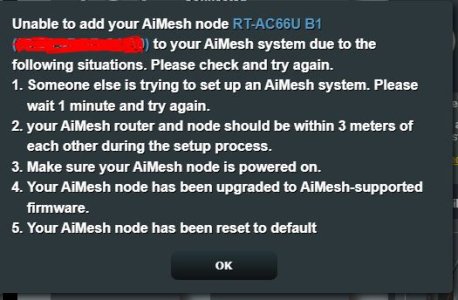

When I search for the Node, it finds it and identifies it but I after a it processing I get the error message.
Unable to add your AiMesh node RT-AC66U B1 (XX:XX:XX:XX:XX:XX) to your AiMesh system due to the following situations.
Please check and try again.
Someone else is trying to set up an AiMesh system. Please wait 1 minute and try again.
your AiMesh router and node should be within 3 meters of each other during the setup process.
Make sure your AiMesh node is powered on.
Your AiMesh node has been upgraded to AiMesh-supported firmware.
Your AiMesh node has been reset to default
If you want to find another available AiMesh node nearby, please click "Search".
I have tried it wirelessly also with the same results.
Has anyone run into this issue before and any recommendations?
