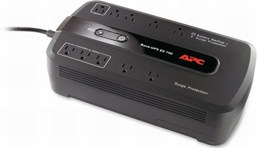

Is it OK to plug the UPS to a powerline adapter passthru, or it will beep? I have an UPS that will alert if it isn't connected to a wall outlet (like most UPSs I guess). I am looking for a powerline adapter "perfect" for me.
I have been searching for answer but cannot find it.
