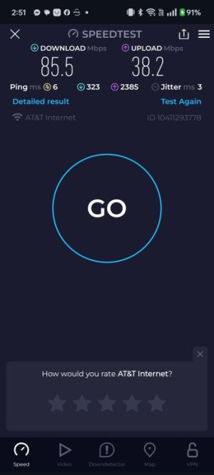

I recently purchased a BQ16 Pro to patch up (horribly) poor WiFi speed in my sleeping quarters. I plugged it into the 120 V wall outlet typical of here in the USA. Everything including WiFi ran great. Then I decided to shore it up with a UPS so if power went out my ASUS network would not shut down. I did not get a pure sine wave version so it is specifically what's called a simulated sine wave (non-pure sine wave) UPS. Low and behold, TERRIBLE WiFi speed!
Ethernet does not seem affected but WiFi becomes terrible!!! (See attached speed test screenshot).
I think I finally found the root of my home WiFi problem. (Some AC adapters may be immune while others sensitive. A recently added RT-AX5400 continued to use the same AC adapter from my old RT-AC68U as they listed the same V and A output, so I guess the older ones may be the non-sensitive ones. The new ones tend to cause grave issues with WiFi).

Definitely seems to have an effect...
These are with the AC adapter rotated 180 degrees (so plugged into Surge protector ONLY side).
Is this the router based speed test or an app in the phone ?
The link rate only changed by about 10%. So i would not expect the local environment to be much of an issue.
Signal strength increased by 2 dB which suggests the client being very close to the AP in the second run and in a different location in space relative to the AP. If you are holding the client and your body position changes, that can affect the RF reception.
Does the change in bit rate hold for any location in the area (room/house/apartment) ?

Did you unplug the UPS from the wall to force it on battery ?
Is the ups plugged into the wall directly or through a plug bar or other device with filtering circuit ?
Good question because most common UPS models in Stand By mode have power output directly connected to the main power. They switch the power output to whatever wave they generate only on main power interruptions. In this case what @jzchen is experiencing may be some noise generated by the UPS electronics itself even in Stand By mode. With so many UPS devices available on the market there is no good way test and know.

Phone app speed test. Ethernet seems unaffected but as an FYI everything is 10 Gbps ethernet except routers that do not support it and the 5 Gbps port on the AT&T BGW320-500. Service is 1 Gbps fiber.
No I did not try forcing it to battery power. The effects of just using the battery side were (to me) obvious.
The UPS is plugged into the wall directly. Prior I was using a cheap surge strip, (but I had forgotten to mention).
If it wasn't clear the UPS, a CyberPower S175UC (Sam's Club if that matters) has two columns of plugs, one side surge only, the other side battery backup. The results were gotten trying to approximate the same signal phone to router, just plugged into battery in one set, and surge in the other.

Must be the UPS itself then. The waveform is unchanged in Stand By. There is a fast relay there switching between main power and battery. You perhaps can hear it clicking on main interruption or self test. Most general use UPS devices work this way.
Looking at the spec, it is a bypass design, which means there would be no difference from running plugged into the wall. Something else is/was the issue.
Yes, the ones with controlled output are much more expensive and not commonly sold in computer stores.
Likely a solid state relay rather than a physical coil / contacts. Expensive to use physical one with high switching speed.
