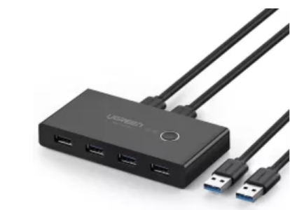

let me share my experience:
my goal was to share 512GB adata m.2 to my network
1/

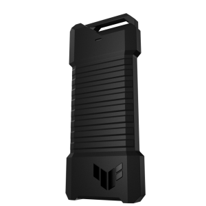

I have bought Asus TUF A1 gaming enclosure,
first issue: no usb-c usb-a cable in the box, I had to buy one (it's not easy to find USB3.1 gen 2 cables).
2/
After connecting it to router, it did not work - led on enclosure was blinking - should be solid.
Router reported no usb device.
Note: it was working on both, my laptop and pc without any problem.
I have bought different cable - no change.
3/

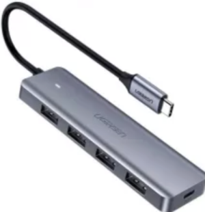

Two cables later I have realized that its power issue.
power USB 3.0 hub to the rescue! I bought one.
I managed to connect both my enclosure and random pendrive, both detected and working on router!
happy ending? ha!

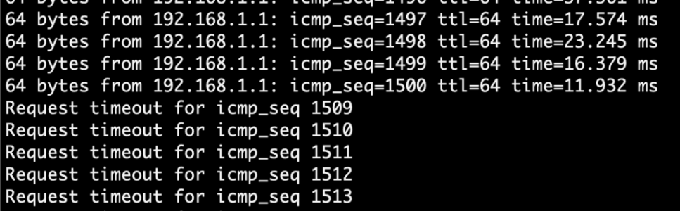

next day morning, I had NO wifi at all (wired connections where fine). Guess what the issue was.
Yup USB hub. disconnecting it magically fixes WIFI, connecting it back in causes wifi ping to die in 3sec.
photo shows that after switching ugreen usb3.0 switch to router connection drops)
FML, waste of time & money
my current "solution": pendrive works fine in router, disk connected and shared via raspberry pi
router: ASUS AX3000 V2, 3.0.0.4.388_22525
enclosure: ASUS TUF A1 gaming
disc: ADATA 512GB M.2 PCIe NVMe XPG SX8200 Pro
hub #1: UGREEN SWITCH KVM USB 2X4 USB 3.0
hub #2: Hub USB Ugreen UGR191
cable: MicroConnect USB C-A Gen2, 0,25m
