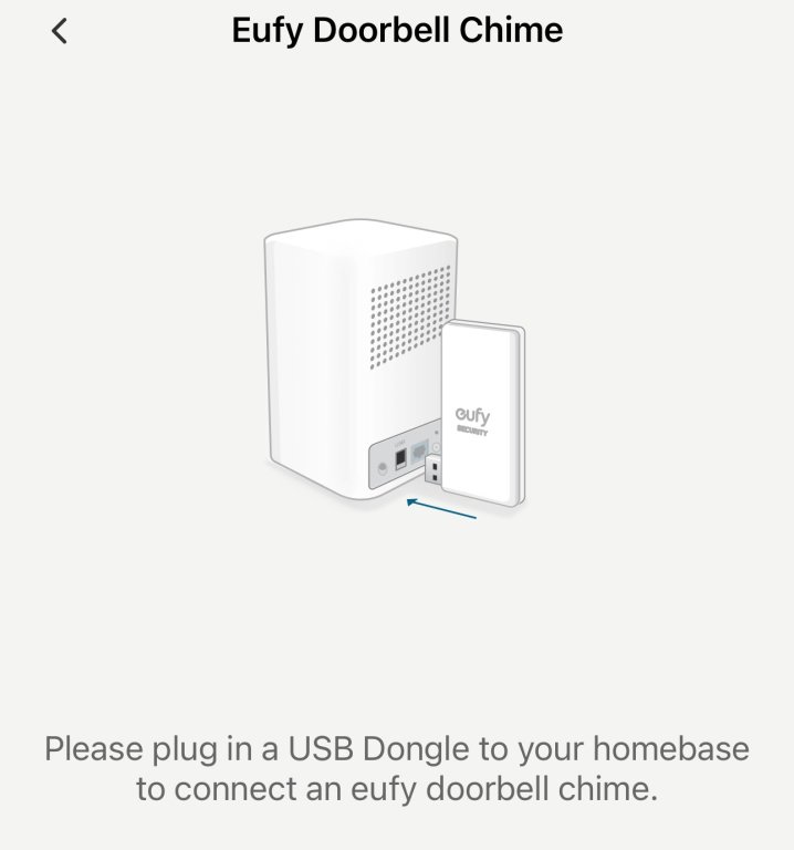

While your at it double check that you haven't set any options in the eufy App to disable the ring from the doorbell (E340 settings) and that you have Indoor Chime configured correctly (for the right chime your using). And all the Eufy devices you reference communicate to each other over WiFi, got to add them all in the App to set them up. So what you show from a connectivy perspective is mostly correct, but both acctually connect to the Internet, the E340 sends a Doorbell pess to the chime over WiFi/LAN. Then depending on the chime, USB dongle from the Homebase (2 or 3) to the chime if using those.
Screen shots of the the Eufy App, E340 settings, indoor chime and detail on tso oh the options, for Alexa integration you'll need the Eufy skill.
Hopefully this helps clarify a bit...
View attachment 63817View attachment 63818View attachment 63819
