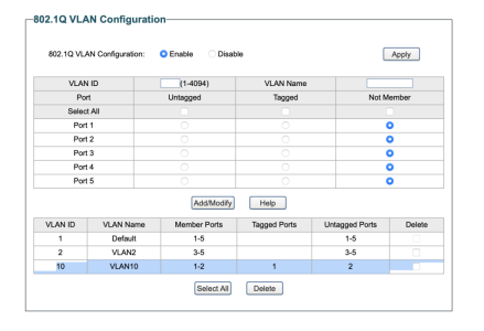

When doing that, Merlin's firmware complaints that "DHCP is not properly setup by the ISP", however, when I plug my managed switch to the ONT (port 1 on the configuration below tagged as VLAN10 ) and then to the router (port 2 on the configuration below), it does indeed work (without any VLAN config on the router). Then I am using the other 3 ports as a separate switch, but not relevant to this.

PS - if it helps anyone these go for 25$ / € etc

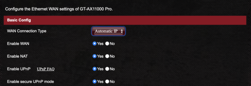

On my case, there are no specifics from the ISP, as it works with the managed switch and the other Netgear router via their GUIs (as is, no credentials) , that's why I am thinking there is something odd with the implementation here, unless there is anything else I can do / test here that you can suggest.

Tried the below (same ISP) and no luck either
What is bugging me is the fact the unmanaged switch and the Netgear do work perfect with this ISP (and the previous ISP that had the same VLAN=10 requirement) and I didn't put any PPPoE or whatever to them, however none of all the attempts I have made to get the AX11000 Pro to connect haven't succeeded.
