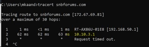

1. Test Result (tracert)
snbforums.com policy based route working

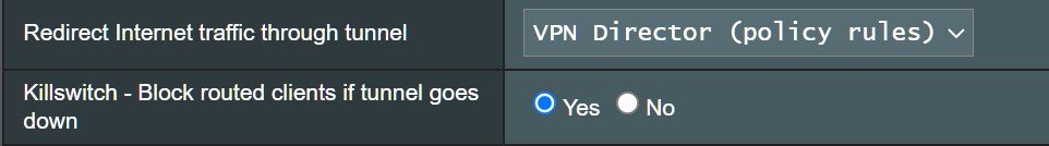

2. Test VPN Director activated:
I didn't change OpenVPN config. Route policy rules still exist and result:
2. Test Result (tracert)
I didn't add any IP related snbforums.com into VPN director. I just tracert same IP that I get Test 1. Result different. Policy based still working If you do not choose VPN Director.

What I can't tell from your test #2 is whether that specific client doing the tracert is being forced over the VPN due to any rules in the VPN Director. That's a requirement for your route directives bound to the VPN to work. All I can assume is that particular client is NOT bound to the VPN.
