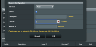

Changing to VPN Director. Mi local is 10.169.3.18. What address should I put in the VPN Director so that all the devices are tunneled? I'm sorry, but my knowledge of VPN is a little more limited.
10.169.3.0/24
