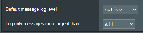

Will do. Give me about 50ish minutes. I just reverted back to the latest release again and set the log level to this:
ColinTaylor
Part of the Furniture
Setting it to this would be better:
There's no real need to change the default message log level.
