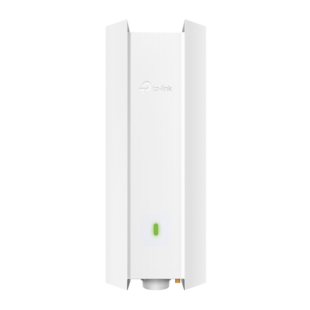

A better solution would be to configure the TP-Link as an access point. Most wireless routers have this as an option.

It disables all the routing related functions of the router as they are not needed. It also turns the device into a DHCP client rather than a DHCP server, so you don't need to configure it with a static IP address. You just plug it into the LAN and it works.
Too much tech for her & doesn't need gig. Only wants to get music and doom scrolling out in the backyard, the porch is covered and price is a factor. The TPLink is $29. thanks for the suggestion as I might use it in the future.
