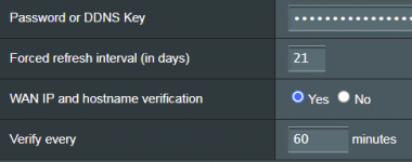

You can't configure the watchdog process itself as Merlin said above. But you can change some DDNS settings, like verification frequency (WAN IP and hostname verification -> Check every), depending on which DDNS service you're using.

I don't have the same firmware as you so I can't check it. Do you see this:
What output do you get from this command:
nvram show | grep ddns_regular

I have Wan IP and hostname verifiction Off
