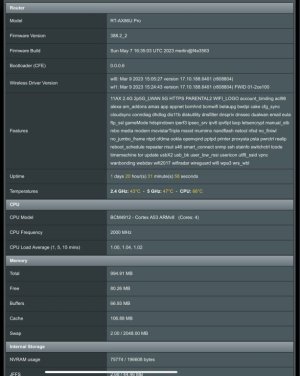

Mine has never been higher than 69 degrees on my RT-AX86U Pro.
I'm currently at 74C... I'll keep an eye on it but I'm not concerned as long as it runs under ~86C. I'm using all LAN ports, the 2.5G port, and trying 160MHz bw again (which has not dropped since I turned it on this morning)... I have no idea if any of this affects CPU temp... may just be variation in the CPU heatsink assembly.
