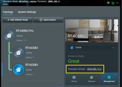

Merlin firmware is not needed on AiMesh nodes. Asus firmware works well for nodes.

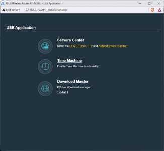

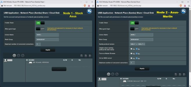

However, there can be a case where Merlin firmware is used on nodes. For example: if you need to use a newer version of Samba to support a USB storage device connected to a node. Still, a NAS is a better choice for storage.
This is from Merlin's documentation
"While Merlin-based nodes seem to work fine so far, there is generally little benefit in running it on a node, so it's generally recommended to leave your nodes on the stock Asus firmware."
