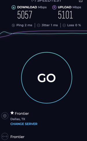

I have the same 5Gbps frontier Fios internet GT-BE98 PRO as main router along with Eero max7 as bridge.
The router's built-in speed test is buggy and I get only 3.5/2.8gbps down/up. But from my Mac or any other PC I do get 5.05/5.1Gbps.

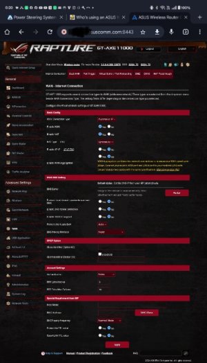

Connected from ONT to router by, Ethernet pretty cool to see that picture when I first saw it I was shocked lol. And yes Internet works

I was able to connect an AXE11000 directly to the Frontier ONT and bypassed the eero Pro 6 completely. (1 Gbps service in Southern California).
