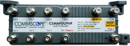

My ISP installed a CommScope CSMF1APDU9VPI, in order to get signal to all of the rooms. Now we are cutting the cord, and I would like to repurpose the individual coax legs for my Gigabit Ethernet LAN. I have purchased a set of MoCA units (ScreenBeam ECB7250).
When I use them in a direct link they work beautifully. When I feed the coax out of the one by my router into the IN port of the CommScope amp and hook up the other at one of the amp’s outputs, I can’t pull an IP from the router. The communication has broken down.
A ScreenBeam tech support agent claimed that my problem arises from the fact that the CSMF1APDU9VPI is not compatible with MoCA, even though it calls itself a MoCA VoIP Amp.
What is the truth of the matter?
It’s a “designed for MoCA” amp with a built-in “PoE” MoCA filter, so no MoCA traffic is allowed between the input port and the outputs; it’s designed to allow MoCA traffic to flow between all output ports, including between the passive output and the amplified outputs.
https://www.commscope.com/product-t...ers-components/rf-amplifiers/itemcsmapdu9vpi/
From the specs tab; the values all seem similar, but note the qualification for “minimum” and “maximum”; input/output path has MIN loss of 35-40 dB; output/output paths have MAX loss of 35 dB.
You could probably get the adapters to link if they were directly connected to the input and output via a short coax, but in their regular locations the additional attenuation of the coax, connections, and other splitters likely puts the path loss above the 57 dB loss limit.

As stated above, the amplifier would still work fine (as regards MoCA flow) if you weren’t trying to feed MoCA signals via its input port. Just connect that line via an output port and try again.
And see my just-prior reply for what you *should* be doing, to optimize the setup. (Consider getting things working via the amp a short-term workaround only.)
Following your suggestion I plugged the coax feed from the MoCA adapter plugged into the router via Ethernet into Out 1, rather than In. That made it work!
