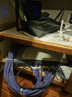

I have an ASUS RT-AX88U right now but security cameras drop off wifi.
House 3200sq ft. 2 stories.

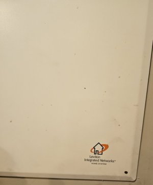

Have a network center (leviton) in a center room in upstairs office in wifi cabinet.
In 2005 installed cat5 cable to most rooms in the house in outlet with phone and TV coax.
All wiring goes through a network panel and connects to a switch. Not using any of the remote hardwired connections except main router RT-AX88U. Not sure how to test that they connect.
I run a lot of devices (smart devuces, security cameras ~20), stream TV in 3 rooms, gaming system Xbox x.
Looking to purchase additional asus unit(s) to set up 2-3 potential AP to help with connectivity.
The camera that drops off most often is driveway camera (wyze pro floodlight). It is closer to router than cameras on the back of the house.
No issues upstairs.
Looking at Zenmesh xd5 3 pack.
Put 1 in downstairs living room in back of the house.
Put 1 in downstairs living room in front of the house (closer to security cameras that drops off)
Future 1 outside in covered patio near pool.

Two such consumer wireless routers (if that's your choice) can likely cover your space... but need to be spread apart, high and in the clear... not buried in a hot cabinet and co-located with other electronics/noise.

I would not connect anything to my network until I need it... and then only one thing at a time, confirming that it works as it should. I would wire everything that doesn't move for robustness and to unburden my radio space/WiFi.
Too much WiFi is not helpful. My 2-node AiMesh covers 3 levels, a detached garage and the surrounding two acres.
Troubleshoot that until you understand what the issue is... maybe the radios are being blocked/distorted by some dense material or noise interference.
No issues upstairs.
Makes senses... closest to the AP buried in the cabinet.
