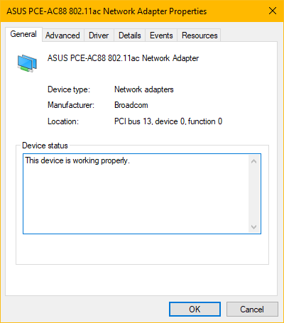

How the heck do I fix it? I'm on a desktop PC running Windows 10 Pro 64bit 1809 (17763.557). All the power saving settings I can find are set to maximum performance. E.g.

It seems this tab doesn't exist anymore? In fact, this tab doesn't seem to exist on any device in device manager anymore
If this is the only PC on your network with the issue, then check the power management on that PC. I would start checking BIOS settings first, then move to OS settings. Do you see Computer -> ACPI x64-based PC in your Device Manager? Does it say "This device is working properly" in Properties? Try to re-install the drivers by removing the devices and "Scan for hardware changes". Sometimes helps.
I have reinstalled the driver for my network adapter, tried a different version of driver and also confirmed ACPI x64 based PC is working correctly I device manager. The problem persists on all tested drivers.
Interestingly, the same problem occurs on another desktop computer in the house (but not on my laptop). Both running the same version of Windows, but this is the only similarity. All hardware is different. The same problem also occurs with the on board wifi adaptor in my desktop PC, as well as the PCIe one pictured above.

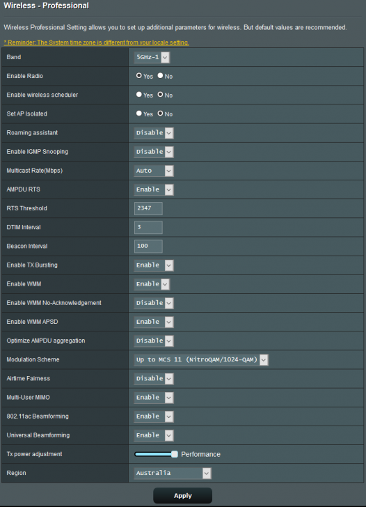

Settings for your scrutiny

After a very quick look at your settings, I would suggest disabling Universal Beamforming on all radios/bands and setting the 2.4GHz Preamble Type to Short. :)
(I'm assuming all the others are defaults). ;)
Preamble Type Long is the Default setting and is recommended for better compatibility with older devices and in areas with high interference and low signal. We don't know how many WiFi networks transmit around ryannathans. Why to change it? It doesn't make a big difference in performance anyway.
Long Preamble type is for older devices, yes. From around 1997 to 1999. :)
Time to move on. ;)
I have not worked on any network with current devices today that benefits from Long Preamble set. :)
True, but even now most routers and access points come pre-configured with Preamble Type Long or Auto. Also, this setting has nothing to do with the issue ryannathans has.
That's why I suggest it be changed. :)
Never said it had anything to do with the issue here. ;)
