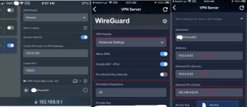

By way of background, I have good working WG and oVPN profiles from my iPhone ←→ ASUS Server and each which works 100% fine on the (Airport) Wifi, with my iPhone connected directly to that Wifi. With either profile I can access home devices, RD etc. (using my iPhone). See attached PIC showing WG Peer VPN Profile in iPhone that works. See also Server settings. FYI in my Asus Router I use Cloudflare 1.1.1.1 an 1.0.0.1 as DNS Servers, hence why the former is added to the WG config.
However using the same WG / oVPN profiles imported into the GLiNET Router, with that Router running in Repeater Mode (connected to the exact same Airport Wifi), whilst these both connect (separate instances) and show that they are connected, I do not get LAN Access to my home (ASUS)? See attached PIC showing WG Client VPN Profile in Router that does not work. I did try adding 1.1.1.1 as an additional DNS to the WG VPN Client config in the GLINET Router too; but that still doesn’t work (it is removed again as shown below).
