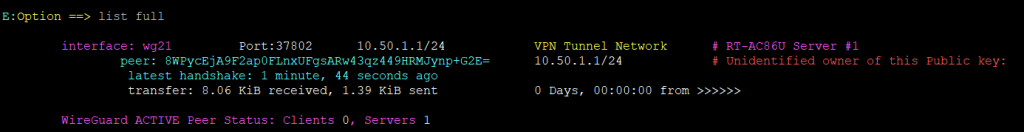

This is what I get when listing for peers (peer corresponding with my client 1):
Firewall is deactivated in the GUI of the router.
I don't do anything yet related to routes or NAT or something else, because I don't know what to do (POSTUP and POSTDOWN commands not supported).
Currently, I am able to ping from my Client 1 the LAN IP of the router (192.168.100.253), but not any other device in this LAN network... except a printer (192.168.100.4/24). I don't know why I'm able to ping only this device. And I don't know what I must to do to connect with the others.
