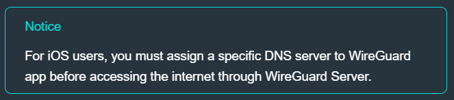

Are your client devices Apple? There's a note when enabling the WireGuard server that says:

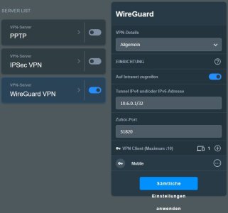

After setting it up, I can enter the data (configuration) into my WireGuard app, but then I can't connect either via Wi-Fi or the public network.
There is nothing there about VPN Director entries.
I use WG (as a fallback to Tailscale) and I have never needed to configure VPN Director to make it work for simple access.
It is simple. I suggest you do not enter the data into your app, just export a profile (wgs_client.conf) from the Router setup then import it into your app. I use the same profile on Windows Desktop app and in iOS.

Only allowed 5 pics here but under Advanced Settings I have Allow DNS=Enabled, Enable NAT-IPv6=Enabled, Pre-Shared Key=DISABLED.
The keys generate themselves BUT if you renew you must export a new .conf file.
Often you will see 0.0.0.0/0 in the clients Allowed IPs field; this will “route all IPv4 traffic from the client through the VPN tunnel to the server, allowing access to any destination on the internet”.
Interesting, I never saw that note before, but as above, I just input the details I have shown in to the Server Setup on the Router (where not auto-populated), export the WG conf file, import it into iOS and Windows and enable it; connected. I am guessing one of those items is the server (where it says DNS Server...).
