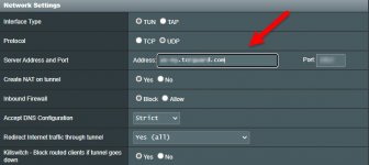

Based on your syslog, it appears you've specified a domain name that resolves to several IPs, and it tries each of them in turn, looking to get connected. Nothing unusual there, just so long as eventually a connection is established w/ one of them. And based on the following …
Service State "ON" Connected "Local: 10.35.0.166 - Internet not redirected"
… that would seem to be the case. But you've apparently failed to select either "Yes(all)" or "VPN Director" for the "Redirect Internet traffic through tunnel" option on the OpenVPN client of the GUI. Without one or the other, nothing is ever routed over the VPN. It just sits there doing nothing.

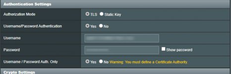

Authentication Settings
"Warning: You must define a Certificate Authority."
Crypto Settings
Keys and Certificates
Static Key Box
(Illustration 6 - unable to upload this message due to maximum already uploaded)
-----BEGIN OpenVPN Static key V1-----
xxxxxxxxxxxxxxxxxxxxxxxxxxxxxxxxxxxxx etc provided by TorGuard
-----END OpenVPN Static key V1-----
-----BEGIN CERTIFICATE-----
-----END CERTIFICATE-----
*** All other boxes are vacant.

Firewall setting: I had forgotten to change "Accept DNS Configuration" from "Relaxed" to "Strict" according to TorGuard instructions, so I just did so.
Torguard Website location: https://torguard.net/blog/how-to-setup-openvpn-with-asus-merlin-firmware-torguard/
Pressed the apply tab once again.
RE: Firewall settings, I could not find an up-to-date illustration of what the "Firewall" should be on the most recent version of ASUSwrt-Merlin Firmware 385.3_2
All Internet examples show "automatic"
Below syslog reflects activity before and after change from 'relaxed' to 'strict' for firewall.
GUI Showing: "connecting..." under "Service state"
Result = "Error - check configuration!"
Is there guidance on firmware's "select All" and "redirect all traffic..?"

TITLE: Changed VPN unique address from words to common IP address format
Greetings'
'Initialization Sequence Completed'
Server Address and Port Issue Corrected
'Redirect Internet Traffic Through Tunnel - Yes (all)' Setting adopted
*** Suggestions failed until the letters were changed to numbers in unique IP address format.
Secondary VPN Router (ASUS RT-AC86U) Connected Devices' were tested for dns leaks and passed.
Asuswrt-Merlin GUI contradiction CA warning remains.
No explanation as this is presumed a function of the vpn service ovpn config generator or other unknown outlier with the GUI.
*** Best regards and thank you again for an apparent successful end result!
