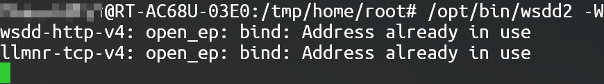

I installed wsdd2 from Entware on my RT-AC68U with Asuswrt-Merlin 384.12. And I noticed that wsdd2 was also imported into Asuswrt-Merlin 384.12. I disabled everything about samba and wsdd2. Here's the output of command ps. (Attachment ps_state.txt)
Here is the output of
netstat -nlp
. (Attachment netstat_state.txt)
Then, I run
/opt/bin/wsdd2 -W
and got errors below
netstat -nlp
. (Attachment netstat_state_with_opt_bin_wsdd2.txt)
Then, I run
killall wsdd2
and
/usr/sbin/wsdd2 -d
, no error appeared.
netstat -nlp
. (Attachment netstat_state_with_usr_sbin_wsdd2.txt)
I can hardly find any differences between the outputs. I really don't why wsdd2 from Entware isn't able to run properly on Asuswrt-Merlin 384.12, although it runs perfectly on Asuswrt-Merlin 384.11_2 and Asuswrt 384_45717.
Comparison between
/opt/bin/wsdd2
from Entware and
/usr/sbin/wsdd2
from Asuswrt-Merlin 384.12 is shown below.
How to make
/opt/bin/wsdd2
from Entware run properly? Is there any solution? Thanks a lot.

I'm sure that there is no process such as wsdd2, smbd, or nmbd before I invoke /opt/bin/wsdd2 -W and get the error, at least I can't find them in the output of ps.
what's more, after I invoke killall wsdd2, I still get error when I invoke /opt/bin/wsdd2 -W. On contrary, if I invoke killall wsdd2 first and then invoke /usr/sbin/wsdd2 -d, no error will come up.

could be a premissions issue where it is denying access or the bind address remained bound at the other location.

@RMerlin and @themiron modified wsdd2 to limit its bondings, bindings, etc. to specific interfaces. Perhaps the Entware version is too "aggressive" in this regard.
https://github.com/RMerl/asuswrt-merlin.ng/search?q=wsdd2&type=Commits

It was the changes made that @ColinTaylor and @dave14305 pointed to, these changes were made to the 384.12 while it was in alpha phase.
