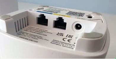

Thanks Tech9. The only issue is that there are no additional LAN ports on the XD5 for other peripherals . I am effectively using the AC66U as a switch! I need to have at least 3 ports.

As I am using Ethernet backhaul, there are no available ports.
You would plug the Ethernet switch into XD5 Router, then connect the XD5 nodes (by Ethernet backhaul) to that switch. Do as Tech9 suggested with the RT-AC66U B1. Should save having to buy a network switch.
