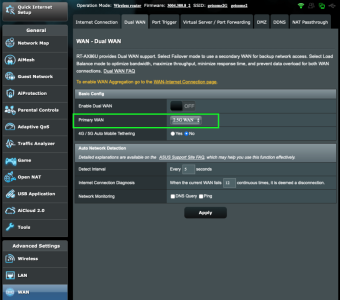

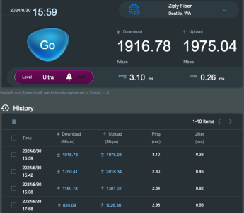

I had a similar issue but I have Ziply Fiber. Just upgraded from 1GB to 2GB. After they upgraded the hardware, I was still only getting a max of 1.2GB up / down on the Asus speed tests. The tech connected his phone to the WAN cable and showed me 2GB up/down.
What I found today, was I had to go into the Dual WAN config under WAN and set the Primary WAN to 2.5GB WAN (even though I'm not using Dual WAN). Now I'm getting close to 2GB speeds up/down.
