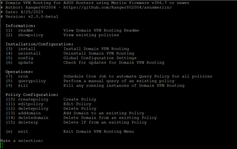

Thanks to @VIper_Rus we were able to patch the script to resolve this issue.
v0.91-beta has been published.
Release Notes:
v0.91-beta - 06/11/2022
- If VPN Director is enabled, routes will now be added to the main routing table.
- Added option for Query Policy All to execute during OpenVPN Events. (If Option is missing run install command again)
@Ranger802004 Could you also include not only the openvpn interfaces but also the wireguard (e.g. wg11) ones? Would this work?
I will try expanding after I get the bugs worked out of the initial build.
another thing i noticed is if the domain being added is already blocked by your isp , policy update doesn't get the ips (obliviously lol) how to get the domain running in this case
For ex: in my case a torrent site is blocked by my isp
i have a nord vpn server running on my router where its unblocked
but i cant update the policy since console runs through my isp
You could create a dnsmasq entry for the domain to use a specific DNS Server that is not your ISP DNS Server.
I'm running a pihole as dns resolver , and this site blocked except through vpn
You still should be able to make an entry in the dnsmasq.conf add on file that will override DNS queries to the specified DNS Server you want per domain.
EDIT: If you have to, you can designate the IP of a DNS Server to go over your VPN using VPN Director or OVPN config and then specify that DNS Server in dnsmasq.conf for that particular domain.
