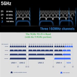

I am not sure if I read this wrong, but in the GT-AXE16000 feature page, it says 3 160Mhz channels, and when I over lay the imae to the 5Ghz Wi-Fi 6 band, it does look like the 3rd channel is UNII-4.
Does look like that, doesn't it? Although I would not put a lot of faith in that graphic being 100% accurate, because they obviously didn't vet it very carefully --- e.g. the channel counts at the left make no sense.
One thing you could check is whether AIMesh on the AXE16000 lets you explicitly select the U-NII-4 frequencies as the channel for the 5GHz-2 radio. If not, then pretty graphics or no, the feature isn't enabled.
