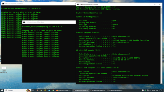

Just found one issue, when OLD router is shut down, ping and connection to both router fail (quite obvious).
But I can still connect to NEW router 2.4 ghz SSID - though not a decent speed.
