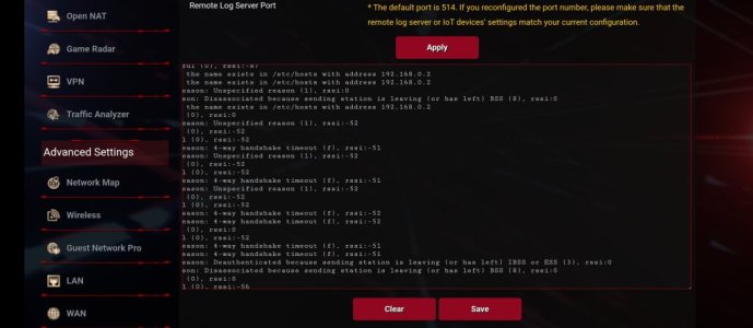

I'm in the UK so it's just the 'normal' BE98 - keep seeing some weirdness on the 6GHz channel with freezes and disconnects with my S24U and the wife's iPhone 15 Pro, checked the router system log and it shows that the device was disconnected as leaving (or has left) IBSS or ESS(3). Rssi:0
This is within a few meters of the router, albeit a floor above.
