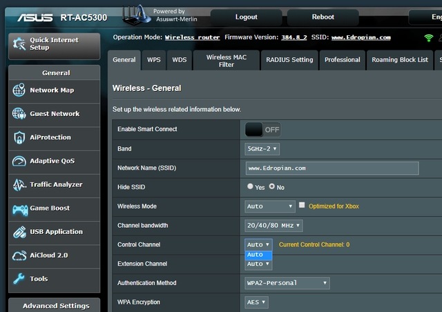

While I was trying to figure this out and see if had to do anything with the
parameters of the band I came across the strange fact that on the 5G_2 band tab under
the wireless settings the "Control Channel" setting is set to auto and it gives me NO option
of choosing a channel manually like the 5G_1 does and in addition to that it says that
"Current Control Channel: 0" every single time. The Extension Channel option is also set
to auto without giving me any options. I think that that this issue i related to the fact that
no channel is under control but I have no clue on how to work around this issue :S (if that is possible)

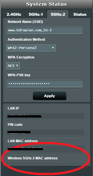

While I honestly appreciate your fast response Andreiv ... after going through this whole thread I am not sure
I saw the relation of my issue with the topic discussed.
The guys in this thread are talking about an AImesh setup which is not my case but I saw a number of reports
regarding the Firmware version 45149 regarding the 5G_2 of being set up as a 5G backhaul band.
The thing now is that my only experience with this router is with 2 firmwares, as long as I just bought it,
one of which is the 45149 of Asus and the latest _2 of Merlin's and in both of them the issue is present now.
With that in mind I said above that before I faced an issue which kept me unable to communicate with the router
through ethernet / wifi and WAN, I was able to see the 5G_2 band with my devices.
After facing that issue and resolved it at last ... from that moment and on my 5G_2 band is absent in both Asus
and Merlin's firmware and in addition to that I am now not able to select a channel for the band as it is locked on
the auto option and channel 0 on that setup exactly as it appears on image above :S

Well I think that I finally found clarity on the issue and now I am happy that the router is not to blame
as to been faulty but furious to realize that Asus is to blame as long as I bought a Tri-band router to
get a 2 band router considering that I am given no option to setup the 5G_2 band to fit my needs.
AndreiV was right to say that the issue is being discussed on the reference thread of his but I got confused
because they were analyzing a mesh setup while the actual imesh refers the actual router :S
(being a newbie sucks until you figure out your router)
With that being said the thing is that the 5G_2 is reserved as a 5G backhaul band and this is why it won't
appear thus it won't capture a channel and it will stay on 0 ...
Based on what I have read all we can do is to wait for an upcoming firmware from Asus to resolve this
after they will probably realize that they have F***ed up.

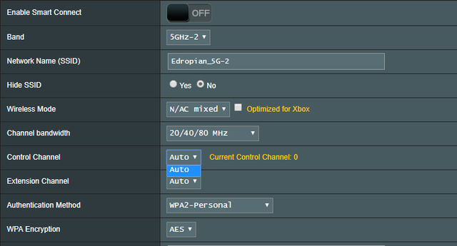

After I read the magic work "defective" you freaked me out again and after I downloaded all the firmwares I found
on the Asus site in order to make tests ... I turned off the smart connect I had put on on the 5G bands and now the
5G_2 gives me the option to chose a channel ... !
Then I turned to the 5G_1 to change the SSID and after I did I visited the 5G_2 again and it was stuck again to auto :S
I did some applies to both 5 bands and now I got it back to give me the option finally to chose a channel ....
WTF is wrong with band after all :S
The thing now is that even if I can chose a channel to capture ... I still can't see it when I scan for networks.
Tried the 100 - 104 and 140 so far but it wont appear on my scans while the 5G_1 appears normally
with 1-2 seconds of delay after every next scan.
Now after digging even more into that, I checked the WiFi icon on the top right and it was stating that even if
while I was on the 5G_2 page and choosing channels ... the 5G_2 had the 0 channel :S which explains that it
could not be found ...
Then I load the 2.4 band page and go back to the 5G_2 page and the band becomes stuck again to the auto
providing no band options and capturing the 0 channel ... pfff ,,,!
Then I started testing the bandwidth frequencies and when I set the 20 MHz and hit the apply button ... it instantly
captured channel 100 on its own ... and appeared also on the scan (on 80 - 40 it was dead)
So ... what is the catch here? ... I don't think that this is normal behavior right?
The only thing that changes on 20 is the fact that the extension channel goes missing while on 40 - 80 it is present
and it only offers the Auto option!
Then I go back to 40, I am given the choice and chose the 108 and I hit apply ... and after the application is done
I am checking the top right WiFi icon and it says it captures 0 channel (no yellow letters saying that a channel is captured also)
then I right click and reload the page like that and everything is fine ... channel 108 is captured and it also appears
on scans ... then I right click again ( while i remain on the 40) and reload ... and it goes rogue again ... choice stuck on auto ...
0 channel captured and the icon on the top right states the same .... but the band appears on scan!!!!!!!!!
After that I chose to move to the 80 bandwidth and I am given at first the option for channels from 100 to 112 so I chose 112
and I hit the apply button ... after it finishes ... i remain on 0 channel and my options now are the auto and 4 0s ... (ahahahahahha)
In the meanwhile I notice that the 5G_1 from 40 it moves to the 80 where the 5G_2 was supposed to be and by now the scan returns
no 5G_2.
Can they coexist on that bandwidth frequency? (I have no clue).
Lastly I make a final attempt to set it again to 20/40/80 and while I am now given options for channel ... whatever I choose
it will remain on 0 (and yellow letters on the right of the choice to verify channel capture)

- After firmware update ... and setup with the wizard: 5G-2 absent / setting it to 20 won't change anything

what is to be noted is that I have noticed that with that firmware the 5G-2 had no Mac Address!

5G-2 again has no MAC address and it is absent and I can connect normally

Nothing changed after all as 5G-2 has no wireless mac address, can not be found with
scans etc ...

* Test with RT-AC5300_3.0.0.4_384_32799-gfe72567 :
After wizard, stuck on summary,2.4 & 5g-1 SSIDs remain the default, I reboot
and redo the wizard,land on home 5g-2 dead, after applying 20 on 5g-2 router
reboots and no band can be found anymore through scans! Resets returned no
result ... same situation

here the 5g-2 finally appeared with wireless Mac Address but remained dead as always
no matter what I did.
* Test with RT-AC5300_384.7_0
again no wireless mac
