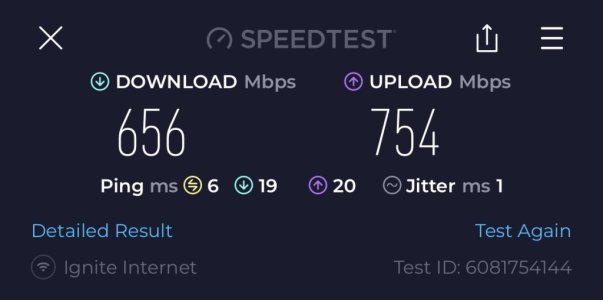

The ping is 4ms. The others are higher during data transfer. Jitter is also low.
This is a test I just took on my phone. What do you believe the ping times should be?

6ms is OK for a ping from a wireless client, but that wasn't what you showed in the first screenshot. Also I think you're too quick to dismiss the numbers "during upload/download" as being OK. The version of speedtest.net that I have doesn't show those stats, but I tried to simulate it by running a ping to my ISP's nearest router while doing a speedtest run, both from my macbook laptop. I saw typical ping times of about 7ms while idle and 15ms during the run. So your values of 25-50+ ms don't look good. They might be explainable if speedtest was saturating the ISP link or the wireless link ... but we started with your complaint that it isn't. So there should be plenty of room to squeeze the occasional ping packet in edgewise.
