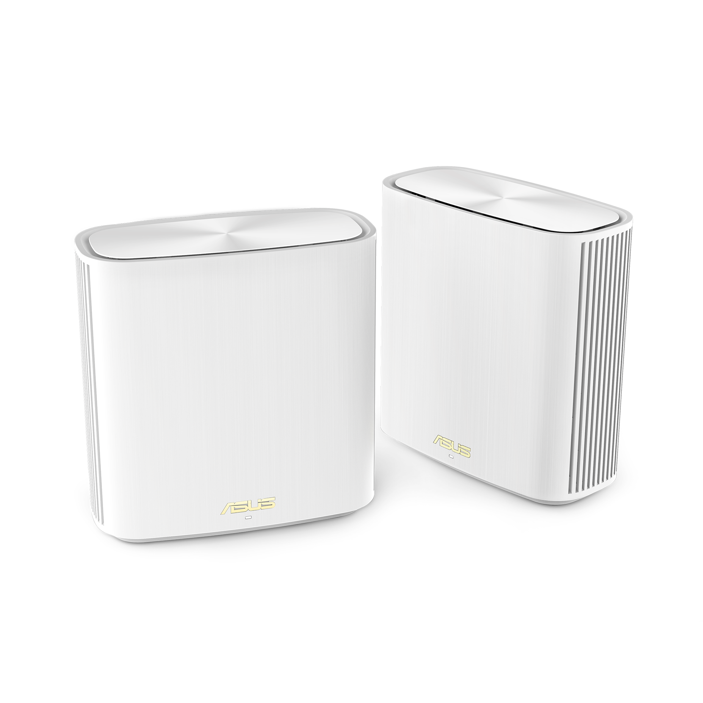

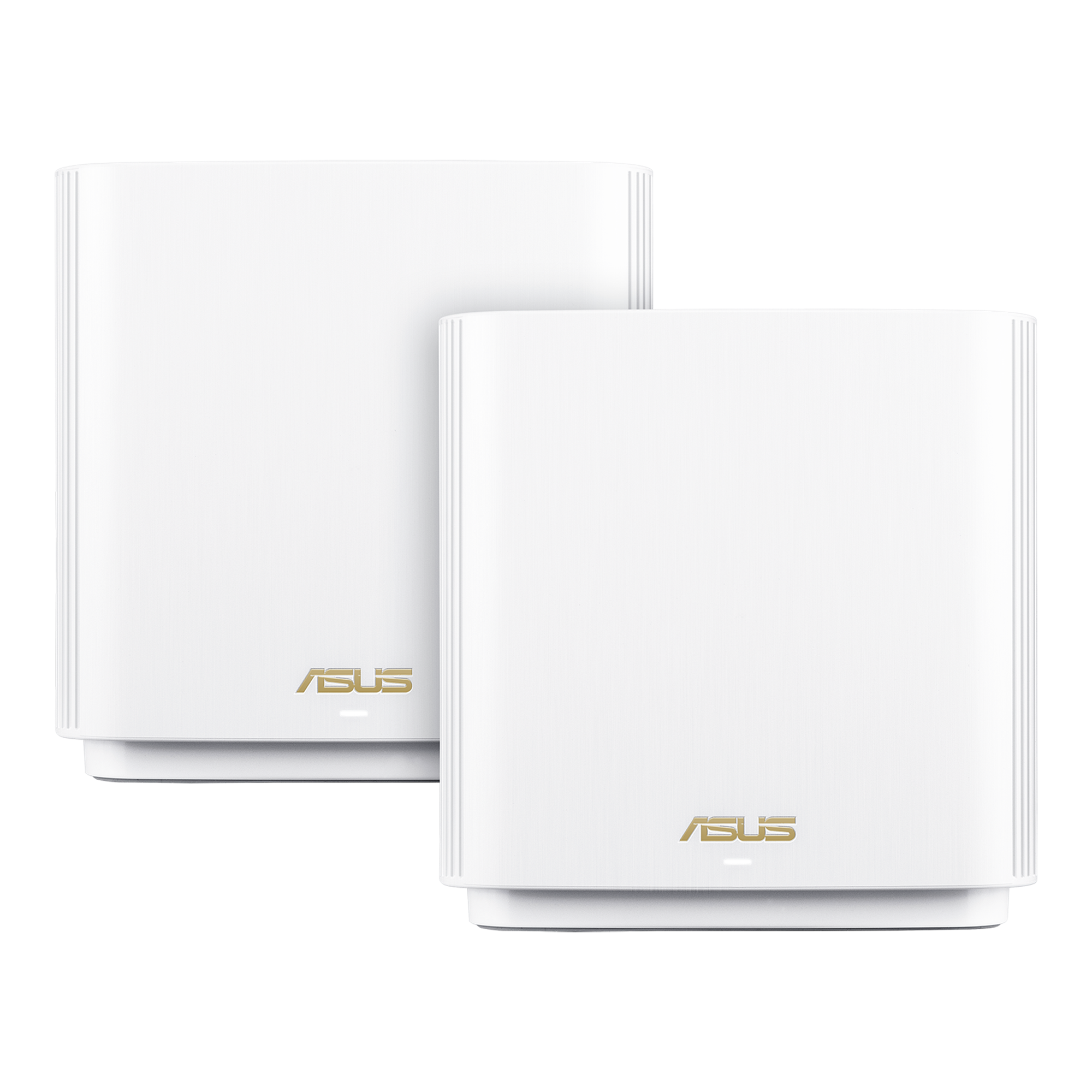

That would be the Asus ZenWifi XT8 then:
