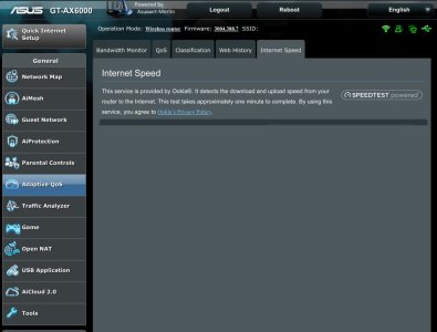

On my GT-AX6000, the internet speed menu is missing and if I fiddle around on this section of screens (going to different tabs), I can cause the router to reboot. Not sure when this got broken but it has definitely worked “at some point”. Any ideas?

1.Try clearing your browser cache & cookies. - Done. This is on multiple browsers and on multiple devices.
2.Follow up questions: Do you use amtm or entware addon's in merlin? ie: scribe, scMerlin, vnStat, AdGuardHome, MerlinAU, OpenSpeedTest (nginx on AP Pro) Yes/No (yes i see your signature just making sure this is all) - Correct this is all that I run.
4.Have you experienced any similar issues with other websites not properly loading? examples addon's that might cause issues AdGuardHome, Skynet, Diversion. - No other website issues
5.Does this happen when entware isn't mounted? - Not tried but I think it might be VPN related. See below
6.Open your browsers inspector console leave a screenshot of your browser inspector console on the internet speed page so we can see if their is any errors, do this with entware mounted and without. They will likely be in red if their is a issue. - Didn't see any errors
So the plot thickens a bit. When I VPN in via WireGuard through my Gl.inet MT3000, I get the missing speedtest but if I go to a local computer on the same VLAN, I see the speedtest just fine. I also just tried via openVPN and after browser refresh it worked fine. My signature has all that I'm running via amtm.

So I tested a completely separate client (iPad) running a different wireguard VPN profile than my Gl-iNet router and I get the same results. With openVPN on the same client I can see the internet speedtest, with wireguard VPN I can’t.

Interesting. On an AX88, it seemed to work but part of the screen is blocked out--I could scroll a few lines at a time (that little dark band on your screenshot). On an AX86U Pro, it triggered a reboot, and then worked. Not going to try again. These two are joined site to site with OpenVPN, and I'm connected via OpenVPN to one of them.

I can confirm that I've also had this problem for a long time when I connect to the routers VPN server, or VPN to a few other family members routers. I can actually see a small sliver of the page, which is enough to run and see the test, but like the pics show, most of the view is blocked for some reason. It happens with both Open VPN and Wireguard.

I don't know if it helps you: I can see the speed test when I am connected to my AX88Upro with my S24Ultra via Wireguardclient over the cellular network.
I took a second look on my ipad and it seems that the frame for the speedtest is too small when I use wireguard. I don’t have this issue natively accessing the page or via OpenVPN.
You could see the speedtest page on your router without any issues via wireguard client?
Yes. Setup was Chromebook -> Pixel 8 Pro hotspot -> Verizon -> AX88U Pro via WireGuard. The Internet Speed tab displayed as usual.
