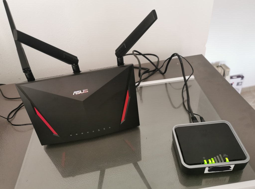

Just wanted to post a update here. I bought the LTE Modem LB2120 and connected it with my RTAC68U router.
The SIM Card is a from Greek provider Cosmote.
Everything works perfectly.

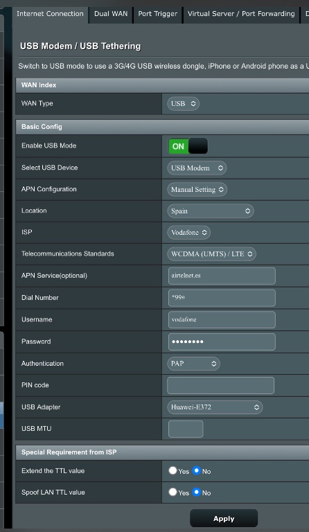

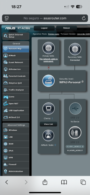

I managed to make it work for Vodafone ES SIM card and HUAWEI E3372h-320 Hi-Link. When connecting the dongle to the router (and after rebooting it), I connected to the WiFi network of the router and went into a Huawei captive portal where I configured the dongle (stick mode and removed PIN).
Router model is RT-AC86U and firmware version is shown in the screenshot.
For the router you can see attached the configuration I used.
I went a little crazy until I realised the secondary WAN was shown as “connected”. 😅
