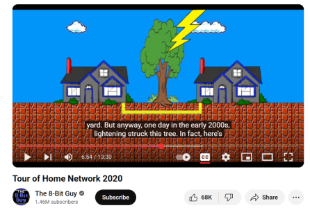

This guy, the 8 Bit Guy on youtube, put a fiber optic connection between his house and the house next door.
Why? His buried regular copper ethernet cable got vaporized by lightning, along with a lot of his gear. Relevant section start at about 5:55.
To view this content we will need your consent to set third party cookies.
For more detailed information, see our cookies page.
The lightning struck a tree in the yard. It grounded, well, into the ground, where the electrical energy found the copper cable.
This was underground--an aerial wire is would of course catch the lightning directly.
So, for those reading later, I would recommend a fiber optic connection, aerial or buried, or, as I think was decided by the original poster, wireless. The connection distance is not far so I think that makes the best sense regardless.
