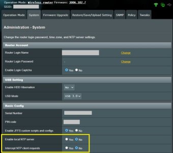

I installed Unbound and the cache it rate never changes and when it starts up I get a warning that the NTP server is not enabled. I cannot find it in either the current AX88UPro firmware or Beta. It is not in Advanced System Content > Basic Config as I have seen with other routers.
thanks
See the 3006.102.7_1 test build Merlin put up yesterday afternoon. It supposedly has a fix for the missing NTP field in the GUI.
I have uploaded 3006.102.7_1 test builds for all models:
For other models this contains a few fixes (like the Wifi 6 devices missing NTPD settings), updates to curl and wget (from the 102_39848 GPL used by the RT-BE92U), the missing Cake settings for the GT-BE19000AI.
I'm going to leave this up for a few days, eventually 3006.102.7_2 will become the final release.

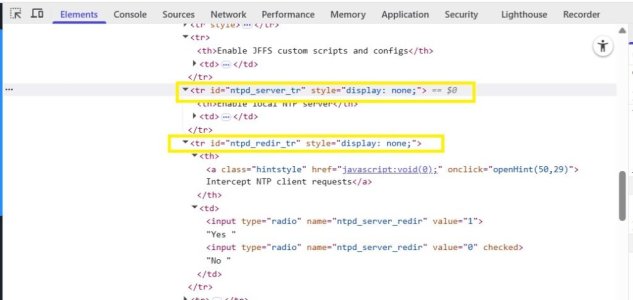

Otherwise, on the Administration -> System -> Basic Config page; use the browser console to temporary delete the code "display; none" for the TR Id's indicated in the following screen capture so the hidden NTP fields shows.

Installation of the browser console? What browser were you using? For example with the Brave browser you hit the F12 key while on the GUI System page to bring up the console, there is nothing to install. Or try right clicking on the Enable JFFS custom scripts and configs area and selecting Inspect. Then in the console's Elements section, look for the following two elements.
<tr id="ntpd_server_tr" style="display: none;">
<tr id="ntpd_redir_tr" style="display: none;">
Double click on the "display: none" for each and it should allow you to then delete the value which unhides the two hidden fields.
Example with "display: none" deleted:
Other browsers like Firefox should be similar (just tested and it works in Firefox Inspect element as well).
I went down the incorrect road of Idefix Terminal. Ok, moving on from that error, I do not see what you are seeing "ntpd_server_tr". I do not get a whole lot but I get three paragraphs starting with [DOM] Password field is. I will keep poking around after lunch.

I grabbed the test build and Whoo-hoo the NTP option is right where it should be.
