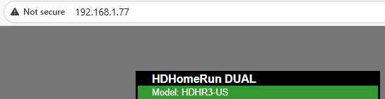

AX88U Pro router <5.0 main wireless> AC68U bridge <wire> HDHR3-US tv tuner
AX88U Pro router, 3.0.0.6.102_33352:
AC68U bridge, 3004.386_52048:
SiliconDust HDHR3-US tv tuner, 20230505:
Browsing from wired PC on router to wired TVT on bridge:
HDHomeRun Software for Windows, 20250815, on Win10.
All firmware is current. Bridge and TV tuner are legacy.

Works here. :)
OE
