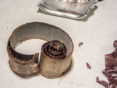

Anything less than 12-18 months old, you're probably ok... after that, power supplies (both internal and external) tend to start going bad...
Sadly, the fluid in the capacitors does not seem to be user replaceable, though with some wire cutters, you can take one apart.
https://c1.staticflickr.com/9/8510/8583976219_c24a146b1f_o.jpg
While on the topic of capacitors, if you have an old router with bulging capacitors, you can easily replace them. Simply look for the capacitance and voltage. You can generally go to a higher voltage rating, but you want to match the exact capacitance.
Capacitors are cheap, and with a soldering iron, solder, desoldering braid, and flux, you can replace the caps extremely easily.
In a decently build router, the electrolytic capacitors will likely be the shortest lived components (though if they are not getting very hot, they can last well over 10 years of continuous use).
I just recapped my Netgear WNDR3700v1 (which has been in continuous use since I bought it right after the model was first released... had to be around 2008) router a few months ago. It had low quality Ltec caps as original equipment, and three of four were bulged. It works very well now with the new caps.
My Netgear WPN824v2 has four low quality caps as well; in this case, CapXons. They are not bulged, but I have not used the router in many years, and even then it was not in service for long (I recall it was rebooting spontaneously a lot, and none of the settings I tried helped). The CapXons may well have dried out over all these years and could be waiting to bulge if I ever plug it in. (Failures without bulging can happen, I understand, but are uncommon.)
My Zyxel X-550 (a touch newer than the WPN824v2 as that was its replacement... also not used in many years) has low-quality Hermei caps, and my D-Link DIR-825 uses top tier Nippon/United Chemi-Con caps. (Edited: I had previously stated that the Zyxel used top tier caps.)
Perhaps you can determine what caps the router model you want to buy (interior images, reviews, etc) has in it (or at least what it might have) before you buy so that you can estimate the odds of needing to recap it. It really is not hard... this was the first device I ever recapped, and I was never a good solderer. I'm better now than I was, though!
Edit: Don't forget to order low ESR caps for the router. That is what mine had, and I am told all motherboards, routers, etc., are going to use low ESRs. Ultra low ESRs were not recommended to me, though, as they have significantly shorter service lives than low ESR caps, even in the top tier of quality, and they're not needed in a router.
