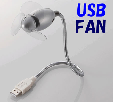

Get one of these and plug it into the usb port.
Adding a USB fan is sort of anti perpetium mobile.
The fan drains power from the USB port, more power consumption means more heat production.
By nature electronics generate heat. The generated heat adds up to the ambient temperature. The higher the ambient temperature, the more problems are expected.
The router must placed such that the heat can escape and the router does not get heated by other devices.
Place the router on a hard surface (leaving some space under its bottom), in an open space with free air circulation (not inside a cabinet) and not on top of an other electronic device (e.g. Modem, TV or DVD player).
Yea, except in this case the "cool" wins over the "heat". Heatsinks work best when they can trap cool air
