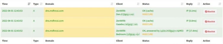

Also -- attached is a pic of the PiHole showing the redirected request from the gateway when it happens.. The first two queries were 2 of them behaving properly and contacting 10.20.1.2... The 3rd was one of them trying to get the answer directly from the 10.20.1.1 machine.
